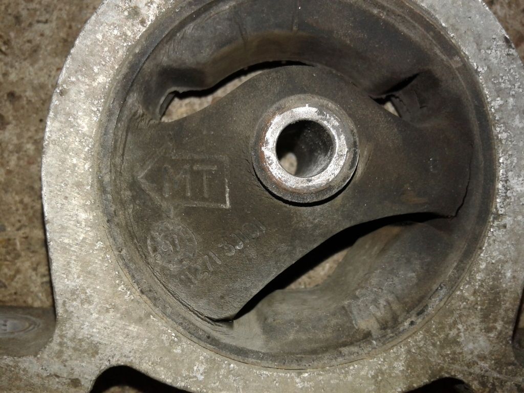

The passenfer side mount was totally gone, no wonder the whole thing seemed to vibrate like hell.

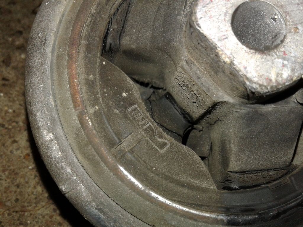

The crossmember mounts were also gone, the front one was the worst.
Front, you can clearly see it splitting.
And rear. This had also visible splits.
